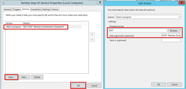

You can create and run these 3 basic tasks in the Windows Task Scheduler of the server machine dedicated to ICS for PDF-
Task No. 1, Stop ProjectWise Orchestration Service
Create a batch file (.bat file) calling the following command,
NET STOP "Bentley Orchestration Shepherd"
Double click on your task in Task Scheduler to edit it. Under Actions tab, click on New. Action should be 'Start a program'. Browse to the batch file. Click OK.
If this does not work, try entering the command directly in the Actions tab as given below,
Program/Script = NET
Add arguments = STOP "Bentley Orchestration Shepherd"

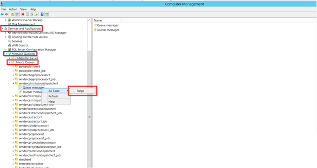

You can also purge the Private Queues under Computer Management>Messaging Queuing when the ProjectWise Orchestration Framework service is stopped. These queues are regenerated on starting the service. This cures jobs stuck in the queues.
