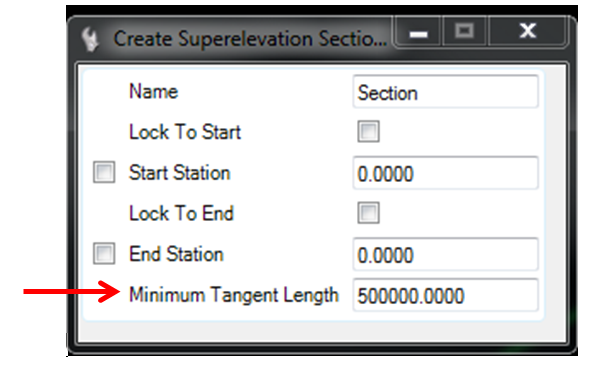

I do not want to have multiple superelevation sections created.  How do I create only one superelevation section for the entire length of my alignment?
Answer:
In the Create Superelevation Section command, set the Minimum Tangent Length to a very large number. This will force the product to create only one superelevation section.
