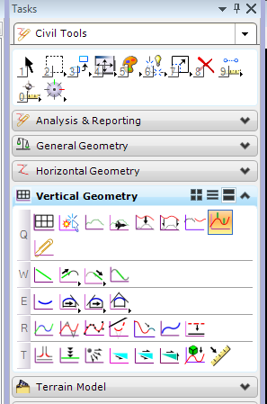

I am trying to create a driveway profile and need to match the grade of the centerline alignment.  How can this be done?
Answer:
Use the Place Profile Intersection Point command to indicate in a Profile View where one element crosses another.  The point is placed at the station and elevation of the intersected element. The intersected element must have a designated active profile.  You can then use this point to create your vertical alignment and tie it into the centerline.
