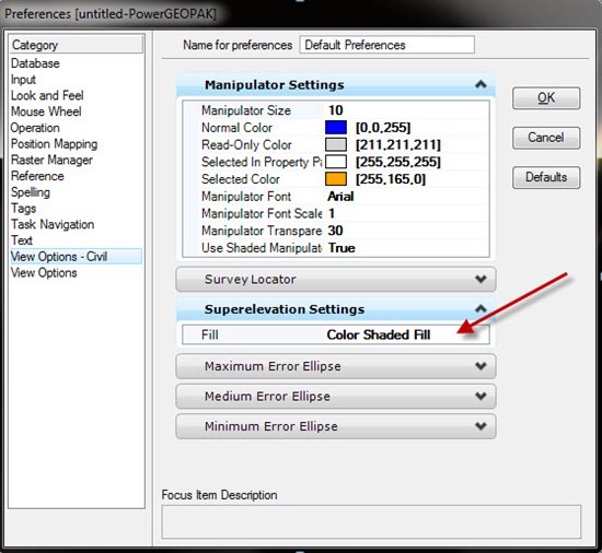

Workspace > Preferences > View Options Civil: Set the Superelevation Settings to "Fill"

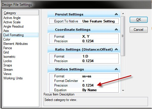

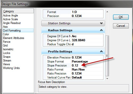

Design File Settings: (Controls the number of decimal places)
