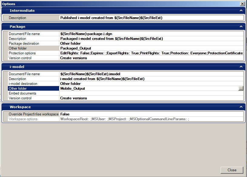

How can I specify an alternative source folder?
The published i-model (i.dgn) always goes into the source folder. You can specify where the packaged and mobile i-model goes in the options under Other folder.
