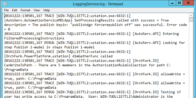

Bentley Automation Service CONNECT Edition delivers a new convenient log file conversion tool with Orchestration Framework. By default, Orchestration Framework logs (%AllUsersProfile%\Bentley\Logs\LoggingService.log) are recorded in text format. Log4NetToExcel.exe can be used to convert text logs into an easy to read Excel format.
Before conversion example:

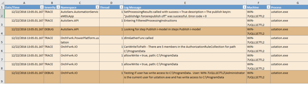

After conversion example:

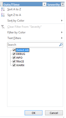

In an Excel format, severity levels are color coded and column filtering can be used to hide unwanted logging.
