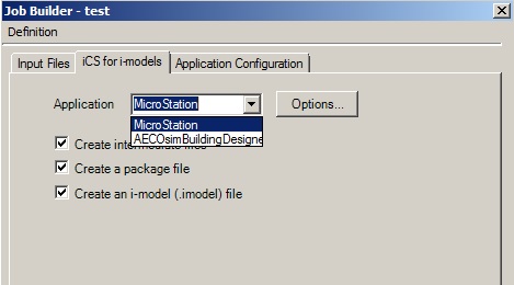

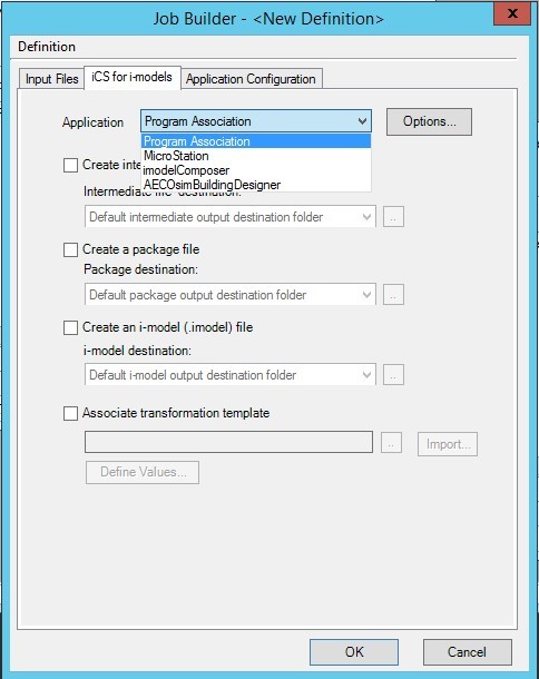

The applications need to be installed on the iCS server with the Power Platform processor.  The user selects the application they want to use as part of the job definition.
When you select Program Association, documents in the input set that have an associated application installed on the server will be processed by that application.  Documents in the input set that do not have an associated application installed on the server will not be processed.  You will receive an error in the Job Monitor window for documents that do not have an associated application installed.
When you select an specific application, that application will be used as the i-model publishing engine to process all documents in the input set.
