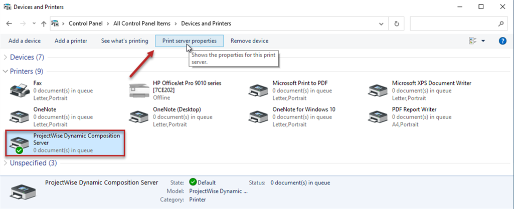

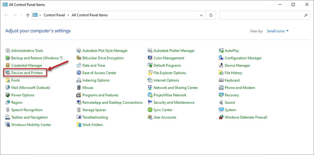

Open the Control Panel and select Devices and Printers.
 Select the ProjectWise Dynamic Composition Server printer from your list of printers and then open its Print Server Properties.

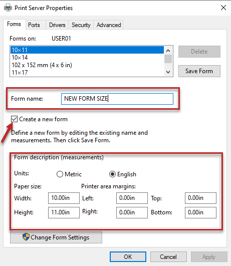

In the Print Server Properties dialog box, check the Create a new form box and give your new “form” size a name and define its dimensions.
Finally, hit the Save Form button and then create another new form (if desired).

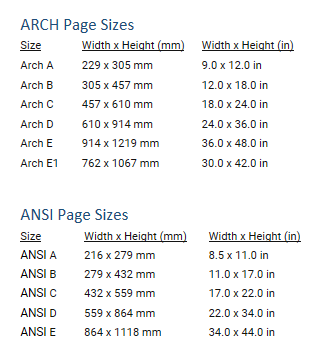

Below is a chart of commonly used form sizes that are not included with the Dynamic Composition Server out-of-the-box:
