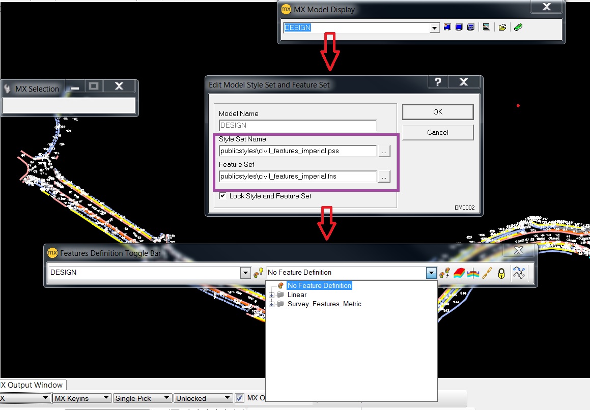

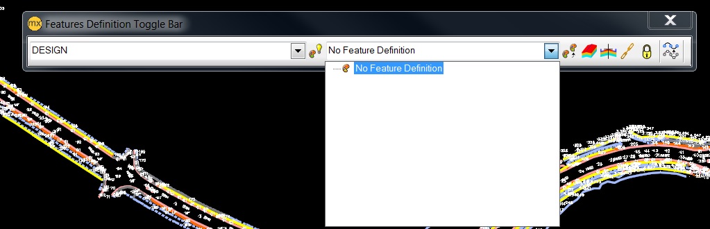

In the 'Feature Definition Toggle Bar', if I select the Design model, no feature definitions are displayed in the dropdown.
This is because the feature set and style set of the design model is other than 'Civil_Features_Metric.pss' or 'Civil_Features_Imperial.pss'.
Change the model defaults to the above mentioned style set.
