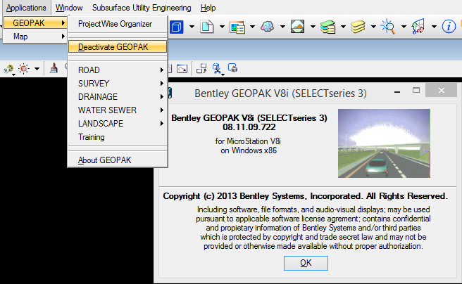

When launching GEOPAK Civil Engineering Suite Select Series 3 or Select Series 4 from the icon and then opening a file that is in ProjectWise I see the Deactivate GEOPAK menu item.
I do not see that when I launch GEOPAK Civil Engineering Suite from the icon and open a file outside of ProjectWise.
Answer:
The Deactivate GEOPAK menu item really should not be there.  However it does not work if you select it because that functionality was removed with the introduction of the Select Series 3 products.  We will work to have the menu item removed for future versions.
