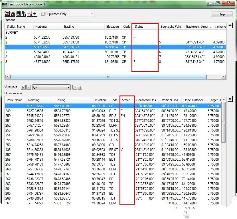

Question:
In the Survey Fieldbook, what do the different codes mean in the Status column?
Answer:
The various codes shown in the Survey Fieldbook are defined as follows:
N: The point has notes.
E: The point has been edited.
F: The point is a keyed-in (fixed) coordinate.
A: The point has attributes.
V: At least one of the attributes has a value.
I: An inserted point.
C An adjusted point.
