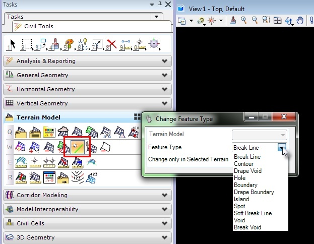

Question:
How do you change the feature type of a terrain model element?  For example, I would like to change a breakline to a boundary element.
Answer:
In the Terrain Model Task Menu, the tool Change Feature Type to change the terrain attribute of an element in a terrain model.
