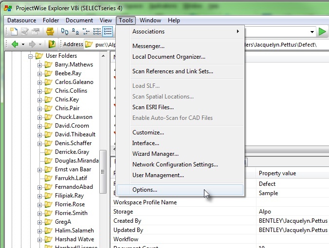

  2. Select Tools>Options in the ProjectWise Explorer menu.

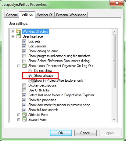

  3. In the Properties dialog, select the Settings tab and navigate to User Interface>Show Local Document Organizer On Log Out.  Toggle on "Show Always".

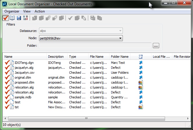

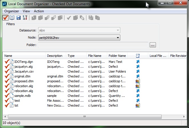

  4. Once this option is enabled, the Local Document Organizer will be displayed when you exit the product, allowing you to check in InRoads files.
