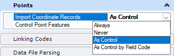

To automatically import fixed points as Control Points, go to OpenRoads Standards in the Explorer and edit the Survey Settings>Points>Import Coordinate Records = "As Control".
As Control - imports fixed point records and automatically sets them as Controls Points so that the coordinates do not change based on the observation/adjustment of these points.
As Control by Field Code - imports fixed point records whose Filed Code is contained in the "Control Point Features"  list and automatically sets them as Controls Points so that the coordinates do not change based on the observation/adjustment of these points.
Always - imports fixed points records, but does not set them as Control Points.  Therefore, coordinates of these points may be updated based on observations and/or adjustments.
Never - fixed point records are not imported.
