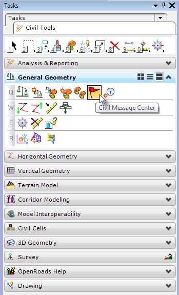

Question:
How do I open the Civil Message Center in OpenRoads?
Answer:
The Civil Message Center can be opened by going to the General Geometry section in the MicroStation Tasks menu.
