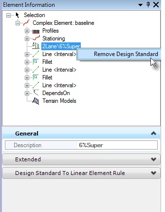

Question:
How do I remove the design standards for a civil element?
Answer:
Open Element Information for the element. Expand the element name and locate the design standard in the list.  Right-click on the design standard and select "Remove Design Standard".
