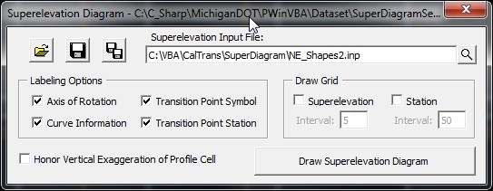

Can I create a Super Diagram with GEOPAK.
Steps to Resolve
There is an old VBA application that will read the shape input file and get the chain and profile name from it and look for the profile cell in the active design file to draw it on.
communities.bentley.com/.../Super-Diagram-VBA-App.zip
