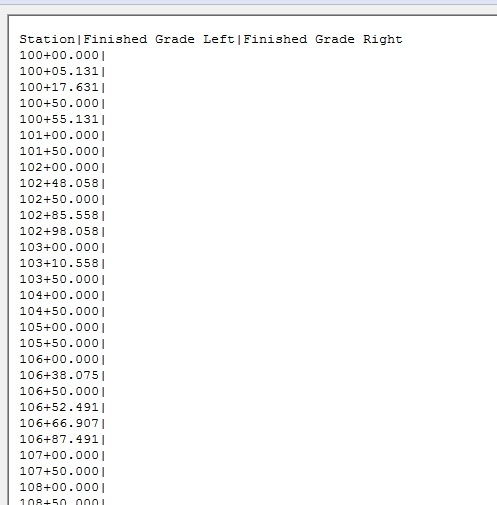

When attempting to create a superelevation report using the style sheet SuperelevationASCIIImport.xls, the results are incomplete.

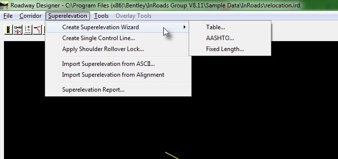

- You must have defined superelevation for the horizontal alignment and corridor upon which you wish to report by selecting the Modeler > Roadway Designer > Superelevation > Create Superelevation Wizard command.

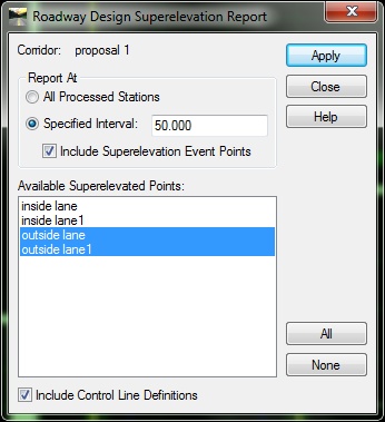

- You must choose either "All Processed Stations" or "Specified Interval" and toggle on the "Include Superelevation Event Points" option in the "Report At" group on the Modeler > Roadway Designer > Superelevation > Superelevation Report command. If you wish to report on only the critical points, enter an Interval greater than the length of your alignment.
- You must select only the two superelevated points representing the left and right range points in the "Available Superelevated Points" list.

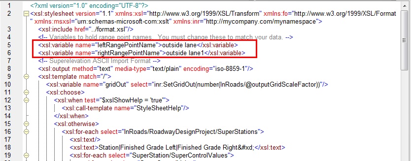

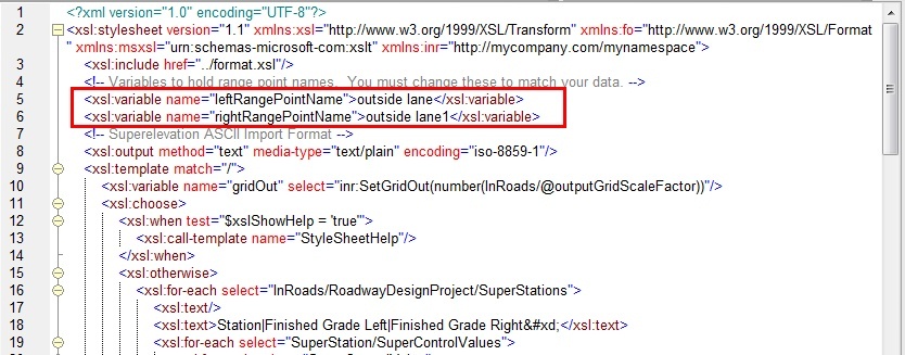

- You must modify the two variables at the top of this style sheet to specify the names of the two selected points to get results from this report. The style sheet is located by default in the folder, C:\Program Files (x86)\Bentley\InRoads Group V8.11\XML Data\en\Superelevation.
