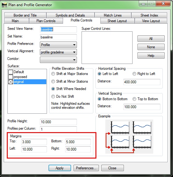

How do I expand the clipping boundary of the profile that is displayed using Plan and Profile Generator?
Answer:
To increase or decrease the clipping boundary of the profile, adjust the Margin settings on the Profile Controls tab.
