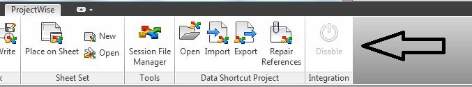

AutoCAD Integrated Applications:
Option 1 – Use the Enable/Disable integration button on the ProjectWise ribbon

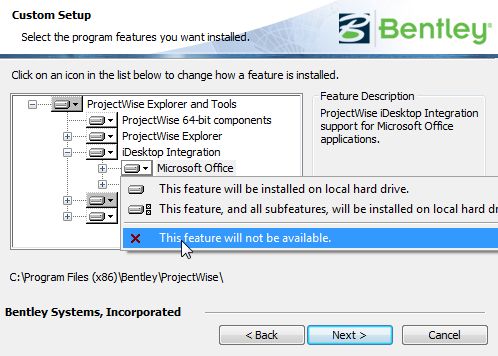

Option 2 – Uninstall integration from the ProjectWise Explorer installer

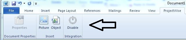

Office Integrated Applications:

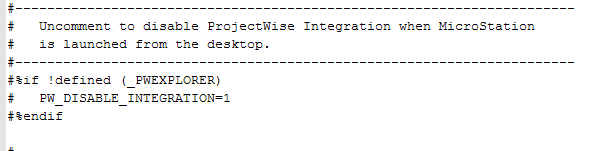

Microstation:
Option 1 – Comment the following line in the PW.cfg file (…Microstation\config\appl\) and  integration will be disabled if Microstation is launched from anywhere other than ProjectWise:
# PW_DISABLE_INTEGRATION=1
Option 2 - Uninstall integration from the ProjectWise Explorer installer
