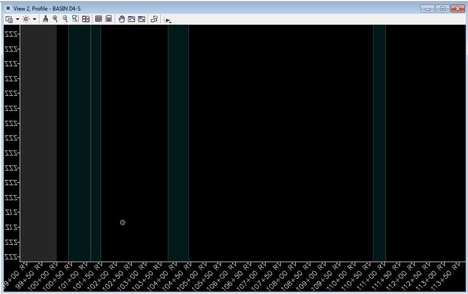

Elevation Axis of Profile Displays Backwards "ZZZ"
Version(s):08.11.09+
Area: Vertical Geometry
Instead of elevations, the profile axis displays backwards ZZZs.

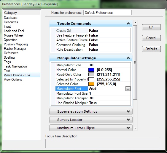

Change the "Manipulator Font" in Workspace > Preferences > View Options - Civil.
