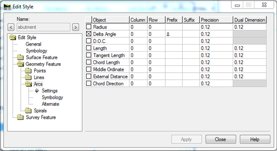

Question:
How can I use a delta symbol (Δ) as a prefix?
Answer:
Simply copy and paste the character below:
Δ
in the prefix field of the Edit Style dialog box.
