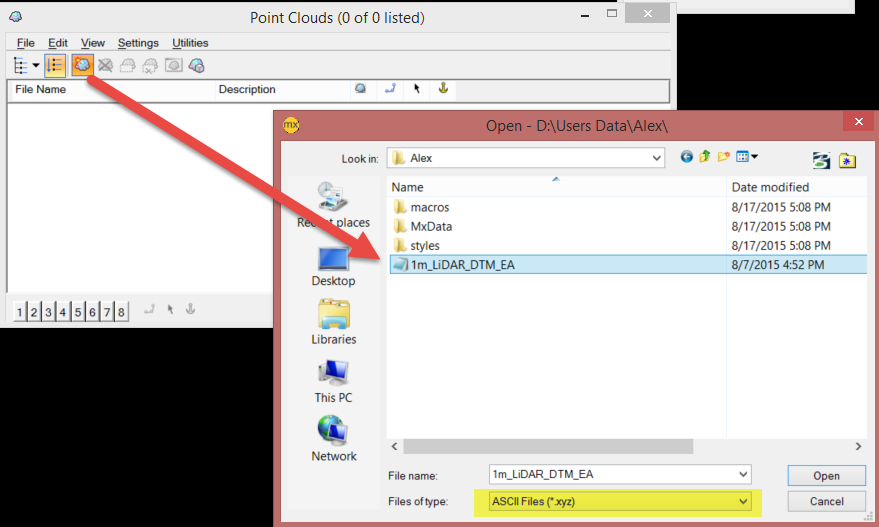

 1. Attach LIDAR file by loading the Point Cloud into the display using the Point Cloud tool (File>Point Clouds > Select File Type "XYZ")
2. Once you import LIDAR data will display the dialog box for Convert ASCII Files.

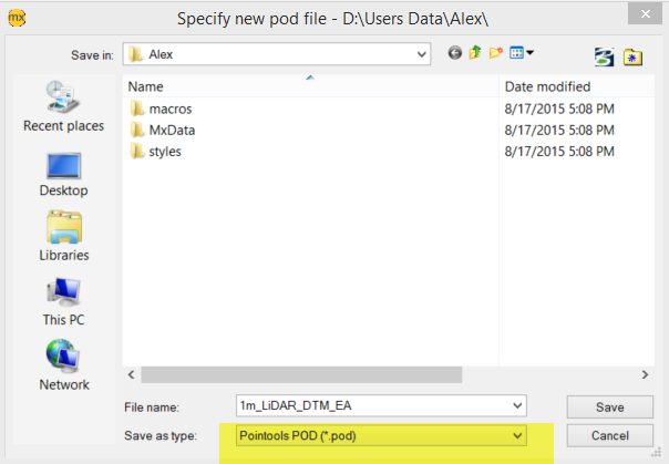

3. As soon as you hit ok, this will brings up the dialog box to save LIDAR Data in POD format.
The point cloud data will always be converted over to the Point tools format POD and the file saved in the same folder as the original data.

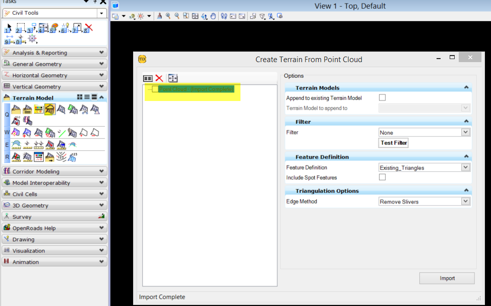

4. Open Civil Tools under task manager > Expand Terrain Model > Create from Point Cloud, now you need to import saved Point Cloud file which is in POD format and then import into current drawing.

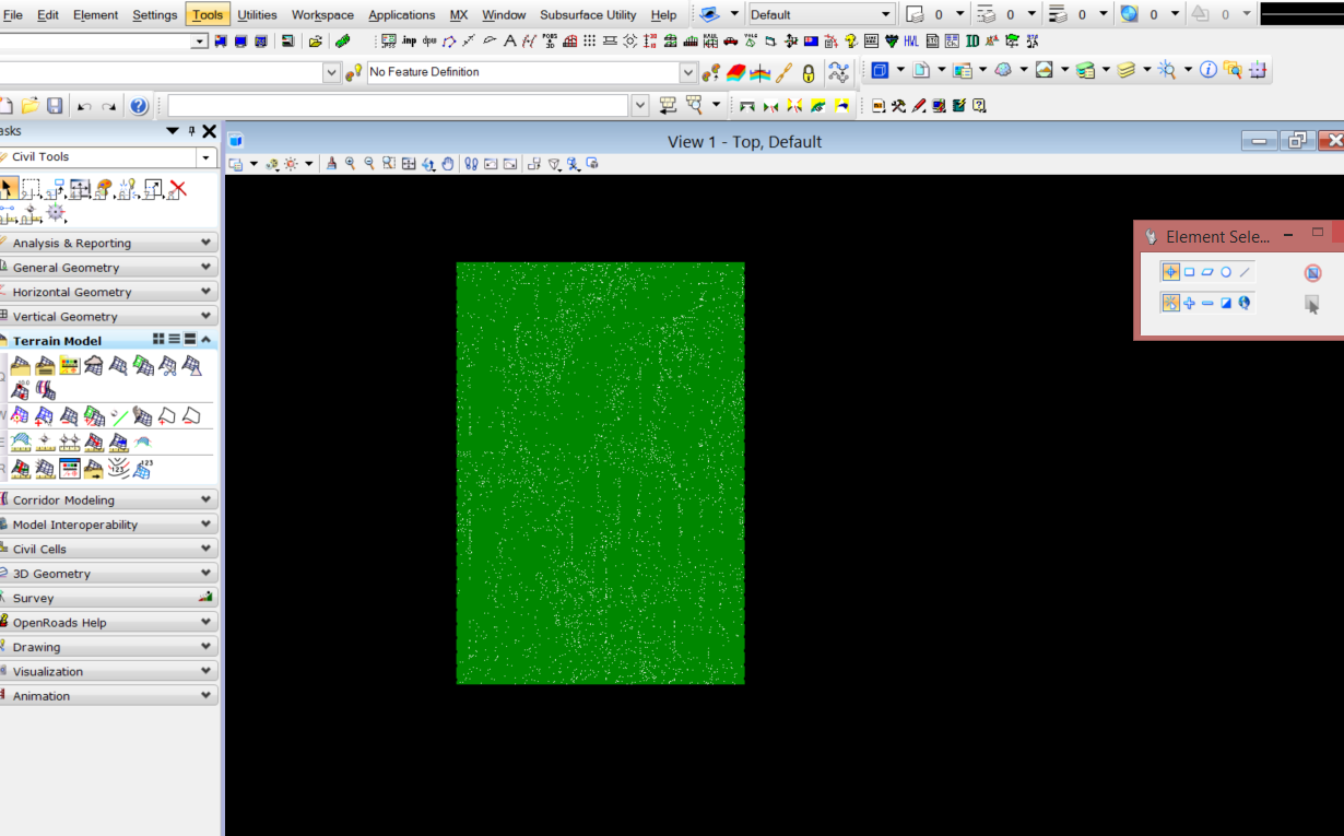

5. Once you import the point cloud data this will display as shown in the below snapshot.

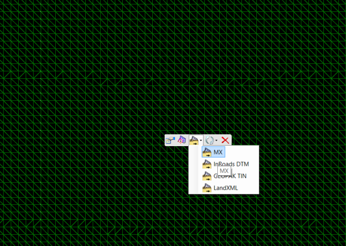

6. To work with MX Road, you need to export this terrain to MX model , you need to hoover on it and export to MX.
