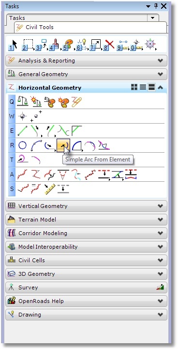

I cannot create a civil cell using elements that were created using Simple Arc From Element.
If you have defined an arc through a “free” data point there will be insufficient fixity. All civil cell elements should be ruled to geometry.
