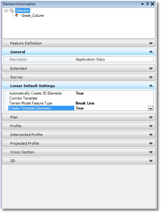

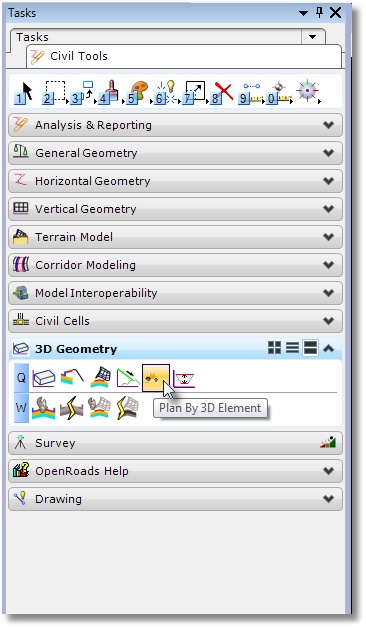

Is there a way to extract multiple lines with the Plan By 3D Element tool?
Answer:
Currently you can only extract one element at a time. However, If the elements are created from corridors, you can set the feature definition to "Create Template Geometry".
Note: A value of "True" for "Create Template Geometry" is not the recommend setting for all features. This should only be true for elements that will be used as a reference for geometry.
