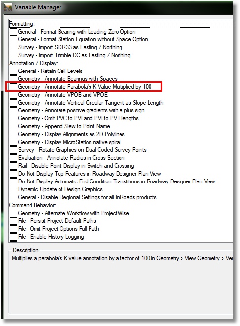

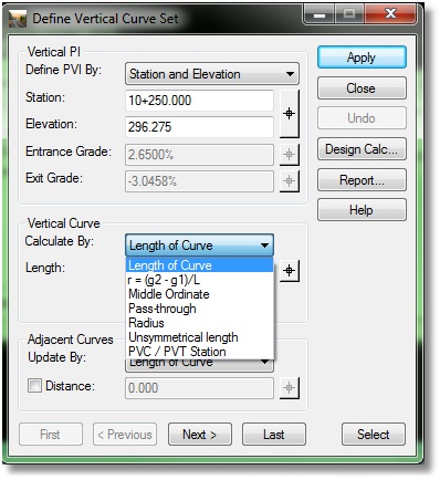

In Geometry > Vertical Curve Set > Define Curve, I do not have the option to calculate vertical curve length using the K value.
Answer:
In Tools > Variable Manager, check to make sure that you do nohave ""Geometry - Annotate Parabola's K Value Multiplied by 100" toggled on.
