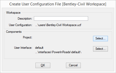

Workspace Installed but not Found - InRoads, Power InRoads, GEOPAK, Power GEOPAK, PowerCivil, or Power Rail Track Software
  1. Start the InRoads, GEOPAK, PowerCivil or Rail Track software.
  2. Create a new User Configuration.
    1. On the File Open window, click the drop-down menu for the User and select New.
    2. Key in Bentley-Civil Workspace in the Name field and click OK.
    3. On the Create User Configuration File dialog, define the Project location by clicking the Select button and browsing to and selecting the \ProgramData\Bentley\{PRODUCT NAME}\WorkSpace\Projects\Examples\Bentley-Civil-Imperial.pcf file.
      NOTE: If you are using Windows XP or older software the folder will be DRIVE:\\Documents and Settings\All Users\Application Data\Bentley\{PRODUCT NAME}\WorkSpace\Projects\Examples\.
    4. Click OK to create the new user configuration file.
  3. On the File Open window, set the User to Bentley-Civil Workspace.
  4. You will now be able to select Bentley-Civil-Imperial or Bentley-Civil-Metric from the Project pick list.

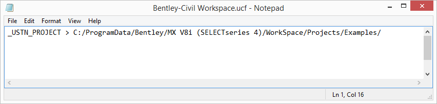

Workspace Installed but not Found - MX ROAD Software
  1. Browse to the Bentley MXROAD installation location DRIVE:\\ProgramData\Bentley\ MX V8i (SELECT Series 4)\Workspace\Users\.
     NOTE: If you are using Windows XP or older software the folder will be DRIVE:\\Documents and Settings\All Users\Application Data\Bentley\MX V8i (SELECT Series 4)\Workspace\Users\.
  2. Create a new text file named Bentley-Civil Workspace.ucf.
  3. Define the _USTN_PROJECT variable in this file as shown below. NOTE: The file path needs to match where your software is installed and will be the same as the path used in step 1.
  4. Save the new Bentley-Civil Workspace.ucf.
  5. Start the MX ROAD software.
  6. On the MX Project Start Up dialog, set the User to Bentley-Civil Workspace.
  7. You will now be able to select Bentley-Civil-Imperial or Bentley-Civil-Metric from the Project pick list.
