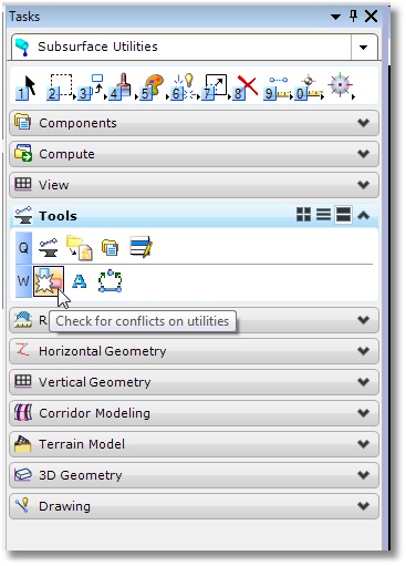

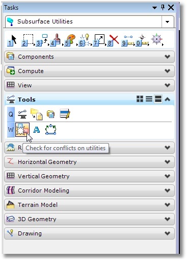

Are there any conflict management tools included in SUDA or is that only available in SUE?
Answer:
The Check for conflicts on utilities tool is not included in SUDA and requires license activation of Subsurface Utility Engineering (SUE).
