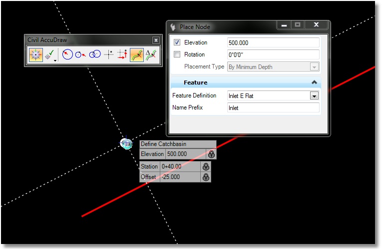

Can Subsurface Utility nodes be placed as an offset to the alignment?
Answer:
Yes, this can be accomplished using the Station-Offset option in Civil Accudraw.
