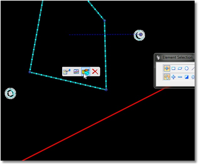

- Open the Utility Properties for the catchment:
![](642380f297fd8e10afb952800153af69.iix)

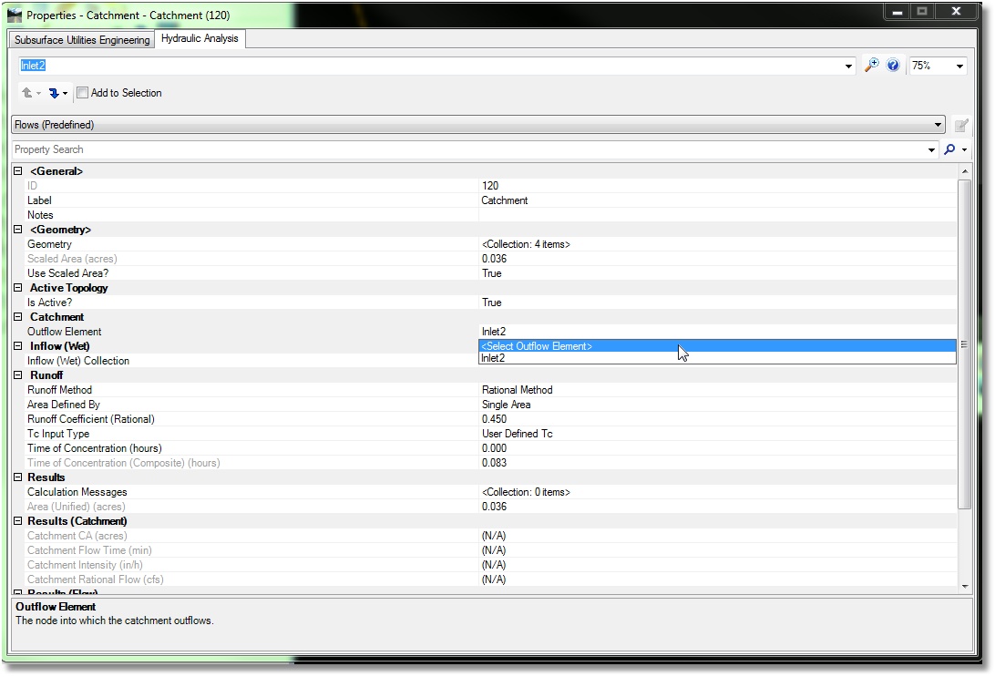

- Click on the Hydraulic Analysis tab and locate Catchment>Outflow Element. In the pull-down list to the right, click “<Select Outflow Element>”.
![](4d23c0ba1b394e10dc6db99f034bcbf7.iix)
