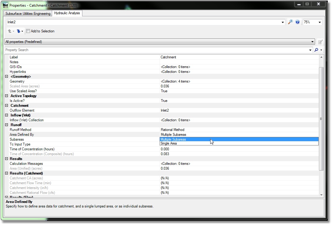

Question:
Can you assign multiple land uses within an area and calculate a composite c-value?
Answer:
Yes, you can define Multiple Subareas on the Hydraulic Analysis tab of the Catchment Properties.
![](ab1380f297fd8e10afb952800153af64.iix)
![](bf1344be47f18e10e3378d53636d43c1.iix)
