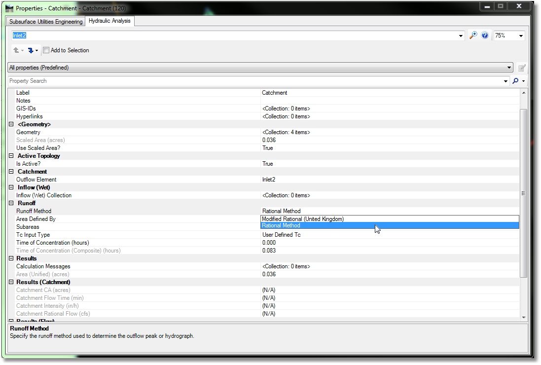

How do you change the runoff method?
Answer:
Runoff Method is a property of the catchment area and can be changed in the Utility Properties.
