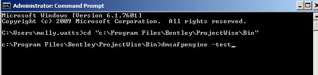

  1. On the server running the processors, open a command line and browse to the ProjectWise installation directory and run  the following:
dmsafpengine -test

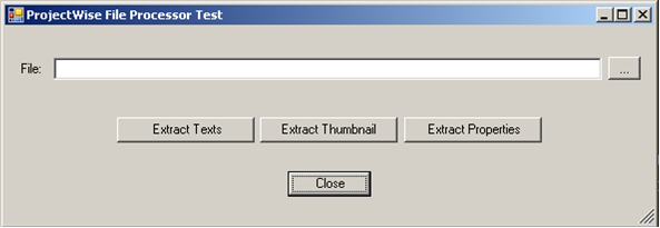

2. The test window will open that will allow you to point to a local file (you may need to export out of ProjectWise first) and test the Text, Thumbnail or Properties
3. This will test that the server is able to extract the data based on the ifilters installed on the server.
If this succeeds, then all should work in ProjectWise and further troubleshooting will need to be followed as to why it is not.
If it fails, then either there is not a filter installed on the server to run the extraction or there is some other problem with the file itself and ProjectWise also will not be able to do so.
NOTE: an exception is running an "extract texts" test against design files will not work, as this tool will not be able to utilize the MicroStation processor
