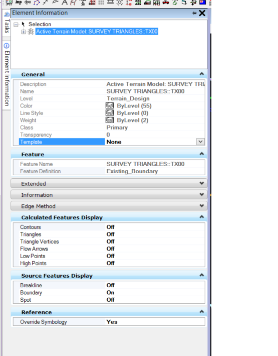

This wiki explains how you can apply an element template to a terrain model. The display of terrain model properties can be controlled by using an element template. You can create an element template with the properties as required and the same can be applied to the terrain using the steps below.
Steps :
1. Select the terrain model with the "Element Selection" tool.
2. From the Primary tools toolbar, select "Element Information" tool. The "Element Information" dialog box is displayed.
3. From the 'General' tab click the arrow right of the "Template Property" to select the required template to be applied to the terrain model.
