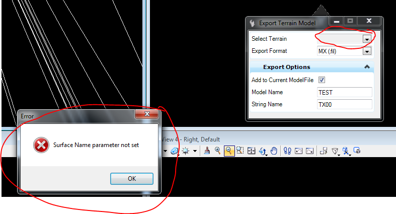

When export Terrain Model to MXRoad it throws a error of " Surface Name Parameter not set.

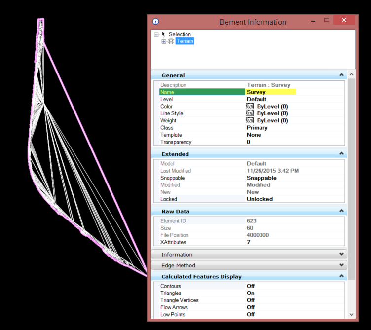

To Resolved:
Select Terrain Model and hit to display Element Information dialog box, select terrain, under General Category enter the name of Terrain, then can easily get exported to MXRoad.
