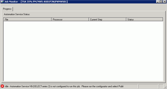

Idle - Automation Service V8i Not Configured
 Product(s):ProjectWise Administrator V8i
 Version(s):08.11.07.443
 Area: Automation Administrator
 Original Author:Raul Guerrero, Bentley Technical Support Group
Problem Description
Idle - Automation Service V8i (SELECTseries 2) is not configured to run this job. Please run the configuration and select Publish i-model document processor(s)

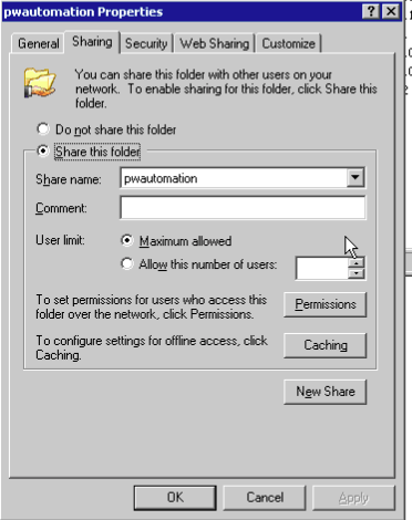

Turn up logging for Orchestration Framework and found that there was a limit on connections. Change the User Limit on the Automation Service Working directory from 1 to Maximum allowed. See figure 2 below.
