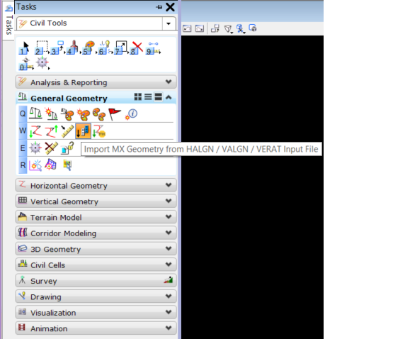

Can we input the MX geometry from an inp file to OpenRoads, as we used to do it in native MX using the input File option?
Answer:
Yes, you can input the inp file in OpenRoads too. Following are the steps:
1. From the "Task Manager > Civil Tools" select the category "General Geometry".
2. Select the option "Import MX Geometry from HALGN / VALGN / VERAT Input file". Select the required inp file.
