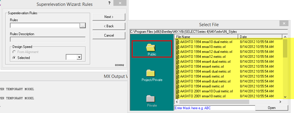

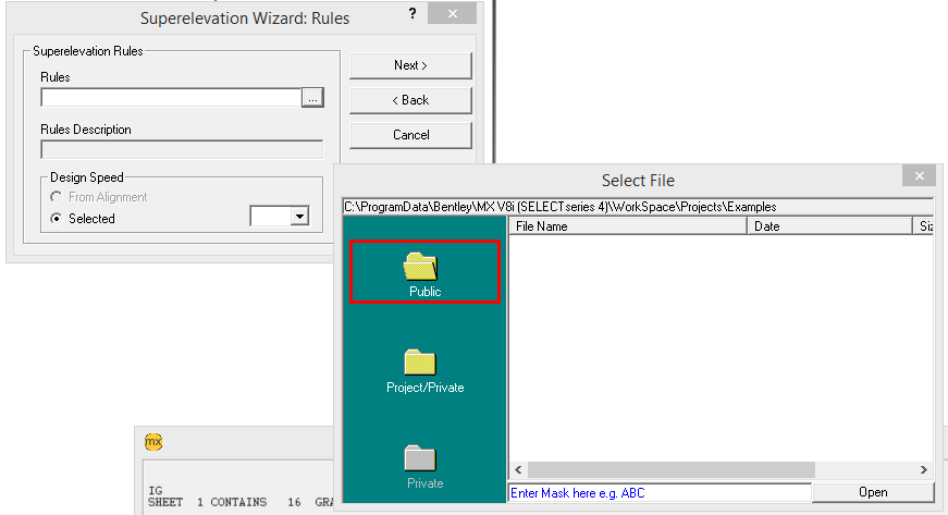

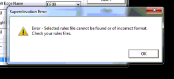

Go to Design > Road Design > Rule-Based Super Elevation, it throws a error "Selected Rule file cannot be found" or you are unable to load the files in Public Folder.
Workaround:
1. Go to workspace > configuration > select CIVIL_SUPERELEVATION_RULES_DIRECTORY.
2. Click on edit and change the path from C:\ProgramData\Bentley\Civil\Standards\8.11.9\en\Superelevation\SRL to C:\Program Files (x86)\Bentley\MX V8i (SELECTSeries 3)\MX\MFW\IN_Styles.
3. Exit and Reopen MXRoad.
4. Hence able to load the superelevation files.
