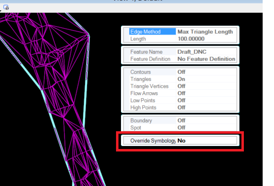

Question :
When referencing a terrain dgn, the triangulation, contours etc options are greyed out.
Answer:
Change the "Override Symbology" to "Yes".
Steps:
1. Select the terrain model.
2. From the heads-up prompts select "Properties".
3. Change the "Override Symbology" to Yes.
4. The options should be available.
