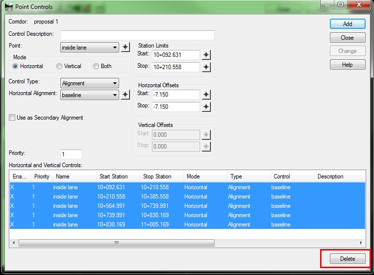

Question:
I applied curve widening to my corridor, but now I would like to remove it. How can I clear out the curve widening?
Answer:
Essentially, the Curve Widening command simply facilitates the creation of horizontal point controls that are applied to backbone points. The end result of the Curve Widening tool is a series of point controls used to widen lanes and/or edge of pavement lines around curves. To remove curve widening, simply delete the point controls by going to Corridor > Point Controls.
