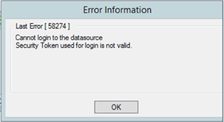

IMS Login – Error 58274 Security token used for login is not valid
Error message and log information
User is able to log in to connection client. User can log in to ProjectWise using logical users. When he attempts login with IMS authentication (while connection client is already connected), error 58274 is thrown
Log reads something like below:

Cause
In this particular case, certificates were changed at IMS so thumbprint provided to the client requesting federation data is not getting validated and connection is termed non-secure. A certificate thumbprint is a hexadecimal string that uniquely identifies a certificate. IMS does not provide any data to such connection and refuses connection.
Usually in such events, client (PWDI server in this case) should be able to re-request and get a new thumbprint. In this case something is stopping it from doing that.
Resolution
Thumbprint for IMS connection is available on ProjectWise Design Integration Server machine in C:\Program Files\Bentley\ProjectWise\bin (for default installation location secection) directory. Find and open Bentley.projectWise.IdentityproviderRP.Core.dll.cfg file (Bentley.projectWise.IdentityproviderRP.dll.cfg in case of old versions).  Contact ProjectWise Technical Support group and get a new thumbprint (they will get it from developement team). Manually replace the value in above configuration file and attempt connection.
