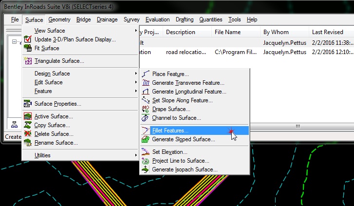

What is the OpenRoads Equivalent to the 'Fillet Feature' Command in Native InRoads?
Version(s):08.11.09+
Area: Horizontal Geometry
Question:
How do you create a fillet between two features using OpenRoads?  This was previously accomplished using the Fillet Features command in the native InRoads product. Is there an equivalent OpenRoads tool?

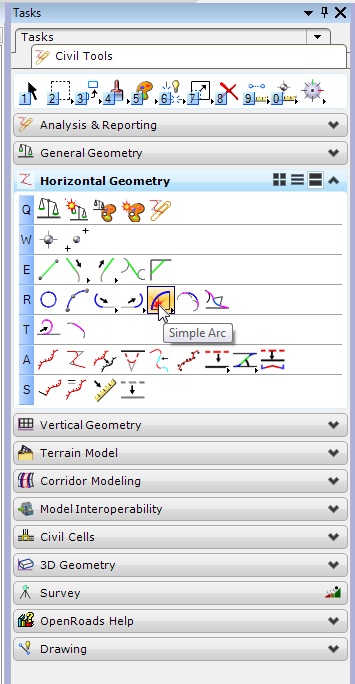

Answer:
The tool used to fillet between two features is the Simple Arc tool located in the Horizontal Geometry section of the Civil Tools Tasks.  This tool constructs an arc between two previously placed elements. This tool has the ability to optionally apply a back and/or forward transition and/or taper between the elements and the constructed arc.
The video at the link below provides a demonstration of this tool.
communities.bentley.com/.../26535.video-simple-arc
