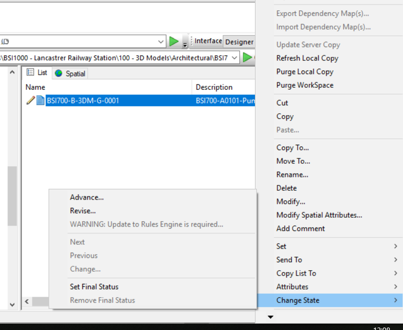

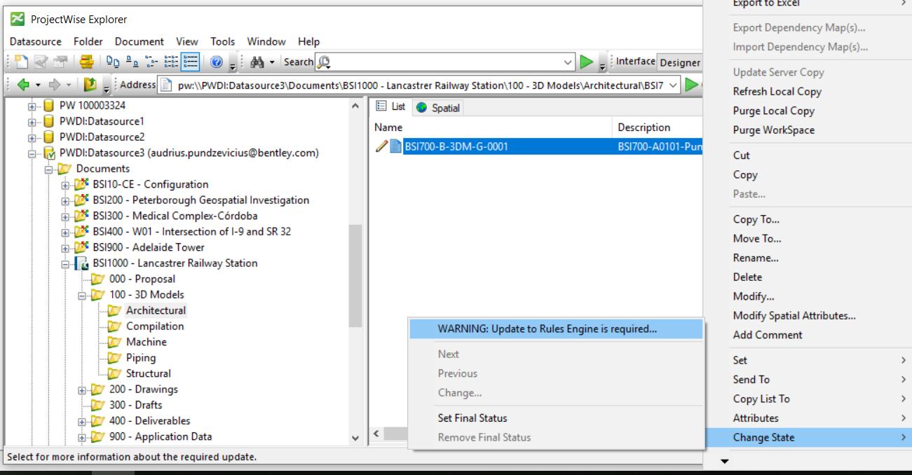

When using ProjectWise Explorer without WRE Security Update 2 and executing rules client-side on datasources that have version guards installed with super user rules, users will see a special warning menu item instead of workflows:

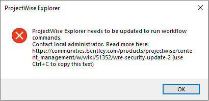

 The menu item displays a standard message box that has a link to a simple page explaining what steps to take:
When using a ProjectWise Explorer that will execute rules on server side, the users will see the usual workflow commands with the warning menu item disabled:
The workflow commands will work as usual. The disabled menu item will be visible regardless if the Explorer client is patched or not and will be removed with future Design Integration server releases.

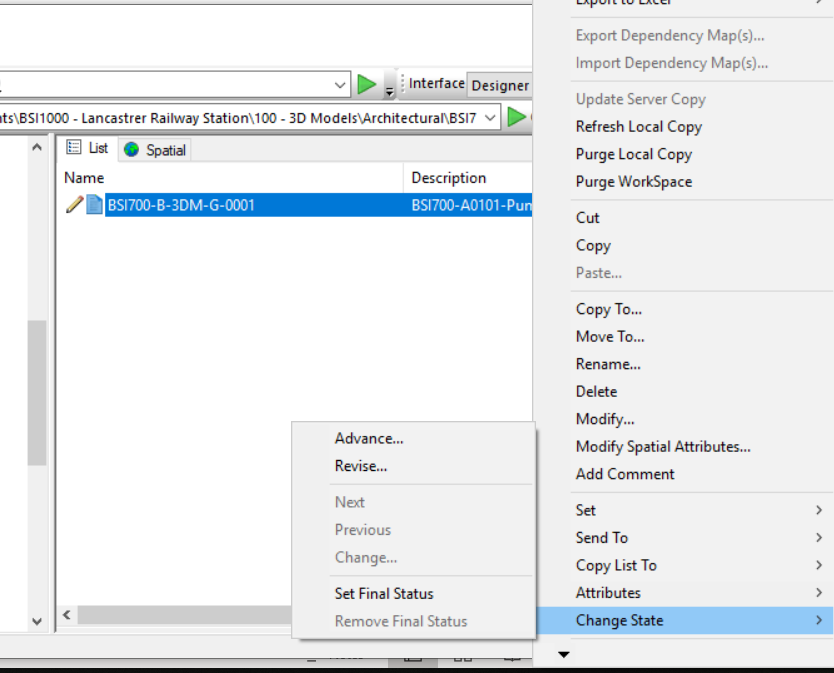

Using ProjectWise Explorer with WRE Security Update 2 or executing rules server-side with future Design Integration server versions will show the usual workflows menu:
