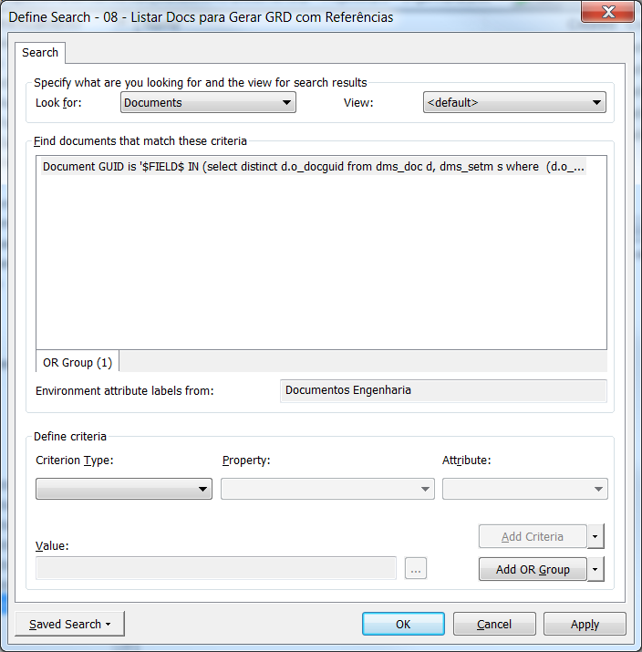

A way to search documents in a specific version and showing related references (references and refer
Just to share a way to search documents in a specific version and showing related references (references and referenced by)
* select 'Search Builder' command
* change dialog windows as attached image
command text is :
$FIELD$ IN (select distinct d.o_docguid from dms_doc d, dms_setm s where  (d.o_stateno=(select o_stateno from dms_stat where o_statename='State_to_Search' )) and   (d.o_docguid = s.o_pdocguid) OR (d.o_docguid = s.o_cdocguid))
change text State_to_Search to state name to search for master documents.
That is all. you also can add additional Criterias
