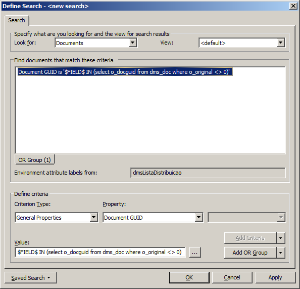

Just to share a way to search only document versions in PW.
* select 'Search Builder' command
* change dialog windows as attached image
command text is :
$FIELD$ IN (select o_docguid from dms_doc where o_original <> 0)
That is all. you can also add additional Criterias.
