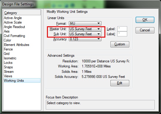

Does OpenRoads have the ability to use US Survey Foot as the working unit?
Answer:
Yes, the working units for OpenRoads are controlled by the MicroStation Design File Settings Working Units. Here you can specify US Survey Feet.
