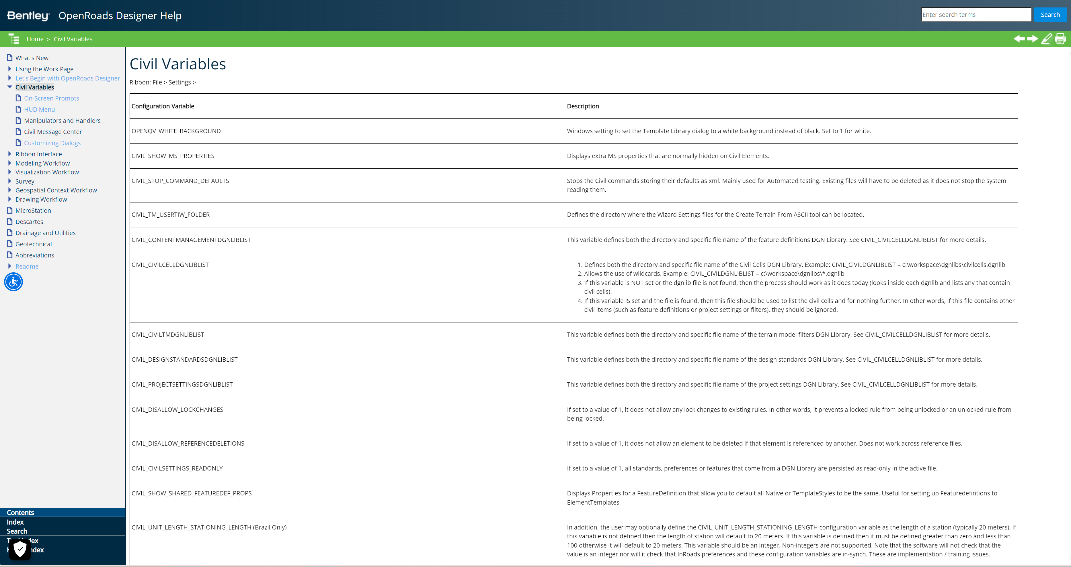

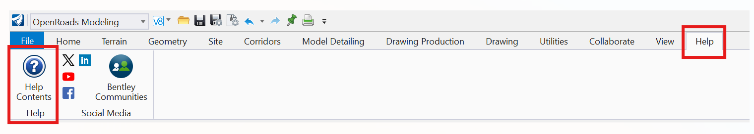

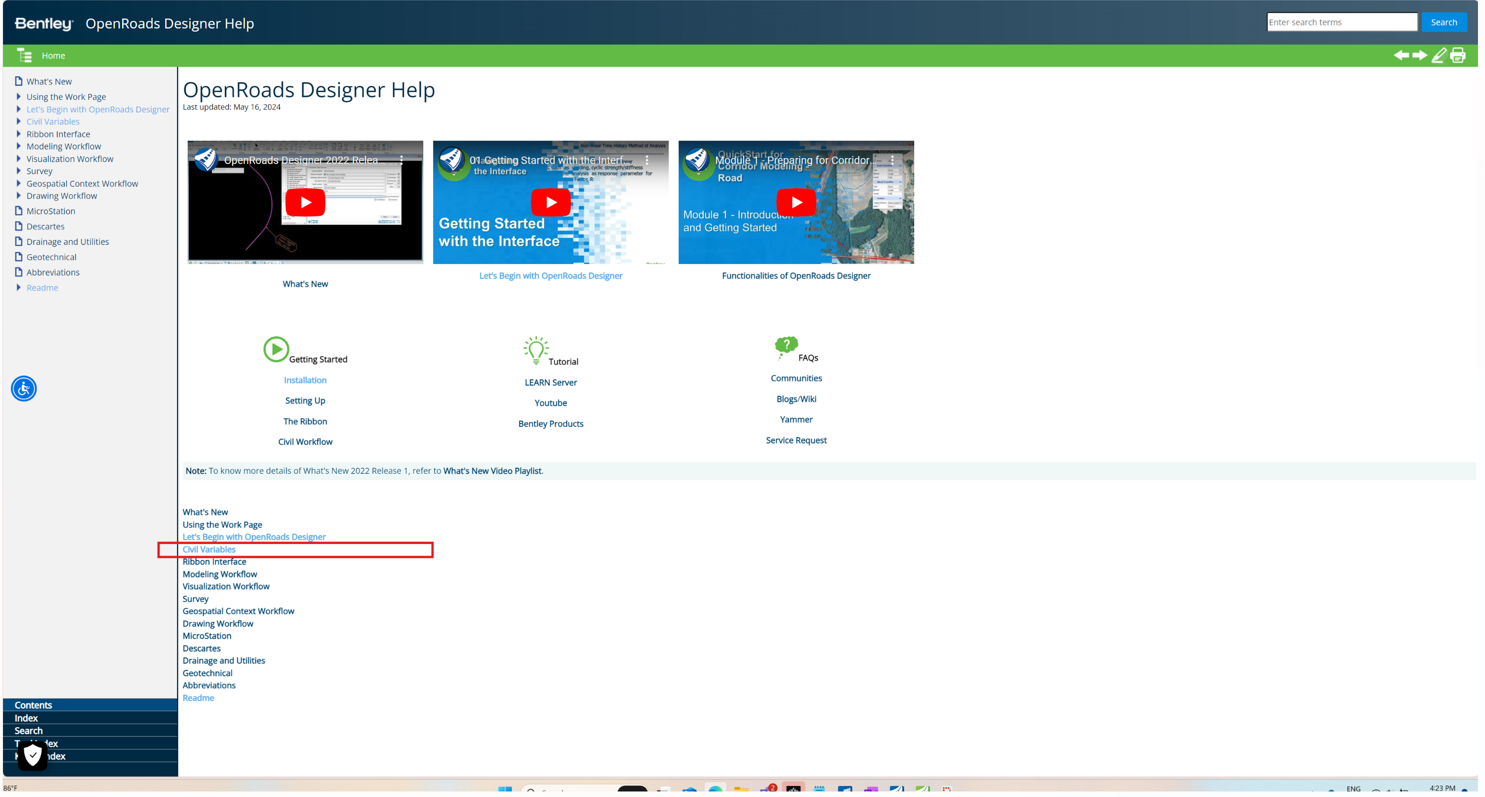

A listing of the OpenRoads configuration variables can be found in the OpenRoads Help. Click on the Help tab in the ORD Ribbon and click Help Contents.
The configuration variables are defined in Bentley OpenRoads Designer Help - Civil Variables.
