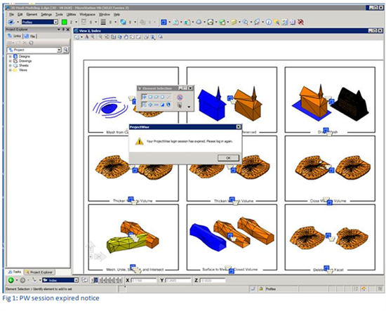

Cached SSO domain login credentials are not expired is failing. SSO Clients are not silently re-authenticated to the datasource.
Findings
In the failed case:
integrated MicroStation SSO credentials are expiring.  The Default lifetime for Client-side cached  login credential used to silently re-authenticate a client to the Integration  Sever is not working correctly and affecting the cached SSO/domain login. The SSO credentials should not expire.

The failure has been confirmed using  MicroStation SS3 version 08.11.09.357 integrated with PWExplorer  version
08.11.11.567 (see fig 1)
Steps to Resolve
Manually reconnect the MicroStation session to ProjectWise by clicking the <OK> button in fig 1 above.
