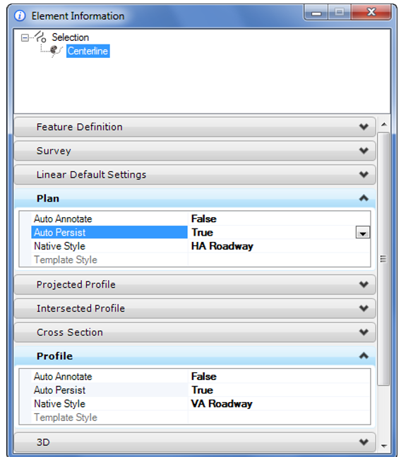

SETUP: Once the link has been made to the native feature files, we can review each feature and its associated settings from Project Explorer. Although there are several tabs (Survey, Plan, 3D, Cross Section, Profile, etc.) that allow an organization to control how this feature will be displayed in each of these areas, only two allow the enabling of the “Export to Native” functionality via the “Auto Export” option – the Plan tab and the Profile tab.
As shown in the following image, these tabs have the options to either enable (set to True) Auto Export or disable (set to False) Auto Export.
In the particular instance of the feature “Centerline” shown in the dialog above, the Plan tab would of course tell the software to Export any horizontal geometry stored with this feature to the native database. The Profile tab would perform a similar function for any vertical geometry stored with the feature “Centerline”.
Note: By default, the Auto Export option is set to “False” for each feature. It is incumbent upon an organization to decide which features if any are to be exported and then enable the option for those particular features only.

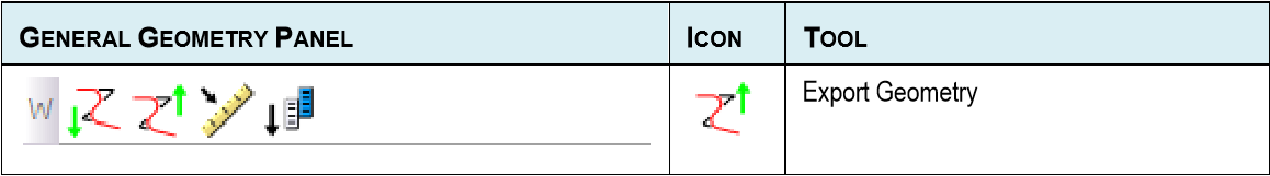

Manual Export: If an organization chooses NOT to implement the Auto Export functionality, then we still has the ability to Export or “export” the civil geometry manually at any time. This can be done with the Export Geometry tool.
