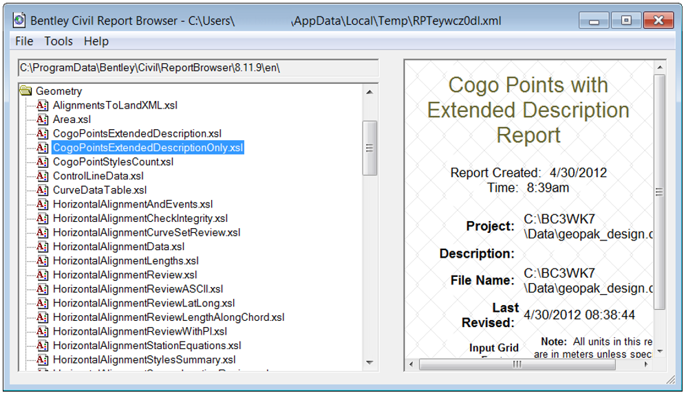

OVERVIEW
The Civil Report Browser is utilized throughout Bentley Civil to generate and print reports on geometry, corridors, superelevation and a myriad of other topics. Default reports are included within the installation.
ACCESSING THE BROWSER
While the users access the browser from the report tools, support staff and those creating / editing reports may access the report browser from outside the product. It is located at:
..\PowerGEOPAK\RoadWayDesign\bin
..\PowerInRoads\RoadWayDesign\bin
..\MXRoad\RoadwayDesign\bin
It’s an executable file: ReportBrowser.exe.

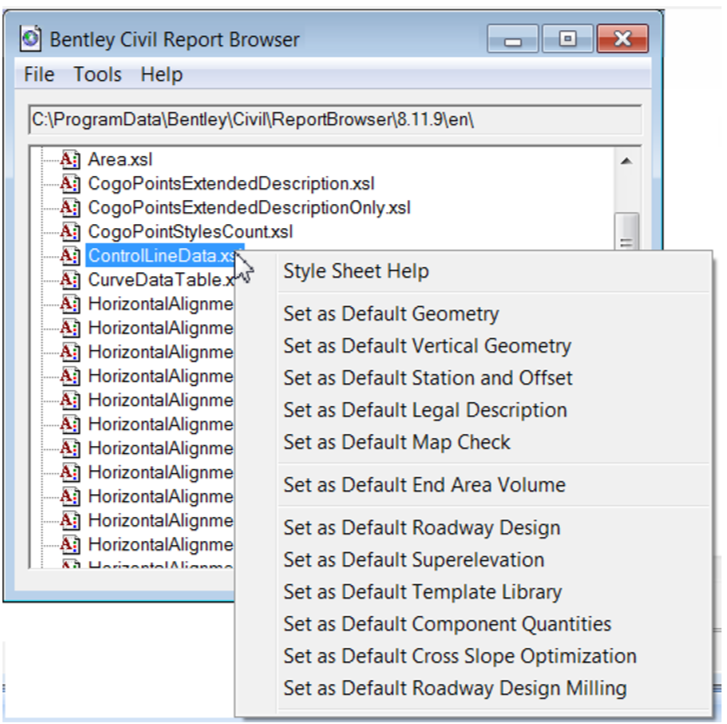

SETTING THE DEFAULTS
Setting the Defaults is accomplished within the Report Browser.
